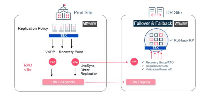

Today, let’s talk about periodic replication, aka”‘Live Sync Direct,” in detail and how differently it functions and addresses your needs. Live Sync Direct enables incremental replication of a virtual machine (source VM) to a synced copy of the virtual machine (destination VM) by using snapshots. It mounts a snapshot then reads data from the mount directly to the destination VM.
This process can initiate replication automatically or on a scheduled basis, without requiring any additional action. Using backed up data for replication minimizes the impact on production workloads by avoiding the need to reread the source VM. Also, in cases where corruption on the source VM is unintentionally replicated to the destination VM, you can still recover to a point-in-time.

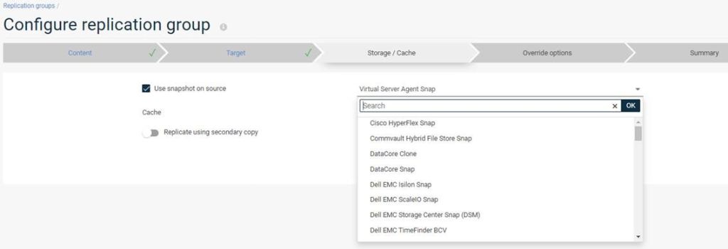

  • With the ability to select a software (virtual server agent) snapshot or a hardware snapshot, Commvault can replicate the VM snapshots with no backups involved. This significantly reduces the replication time.

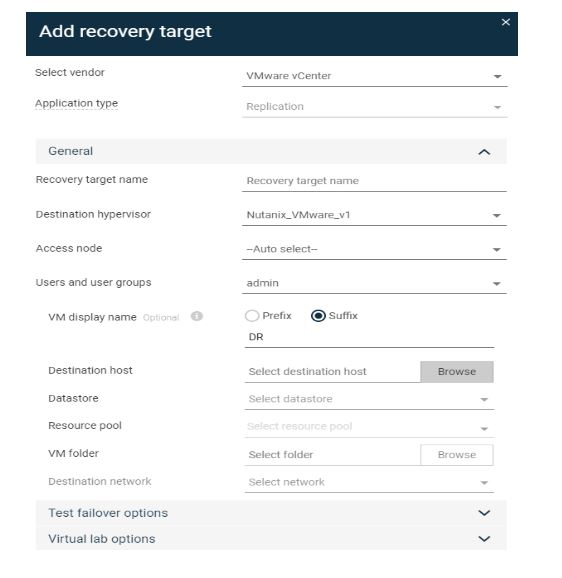

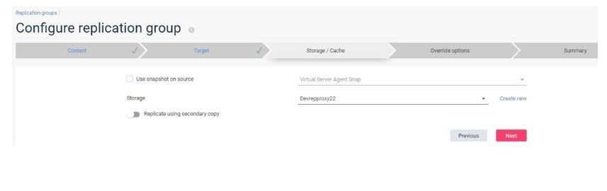

A replication group can be configured in 4 simple steps:

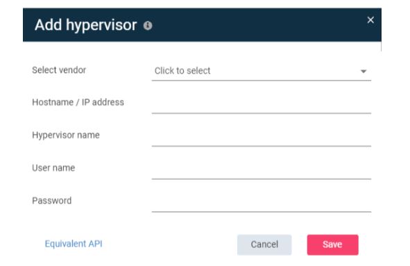

1. Add source hypervisor to select the VM’s to replicate.
2. Add the destination site for replication.
3. Select a storage location for recovery points. This also allows you to select a hardware snapshot or a virtual server snapshot for the source.
4. Monitor Replication.

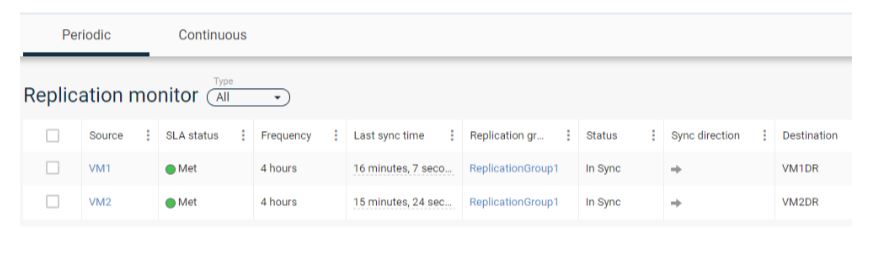

Monitor all the VM’s (both periodic or continuous) that are being replicated. This dashboard also provides you with vital statistics such as SLA status, last sync time and frequency.

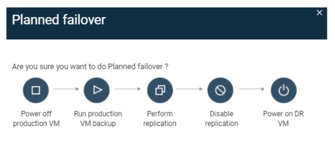

  • Planned failover: Initiates a failover to the secondary site after updating the destination VM with the most recent changes from the source VM.

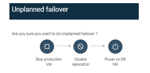

Unplanned failover: Initiates an immediate failover to the secondary site.

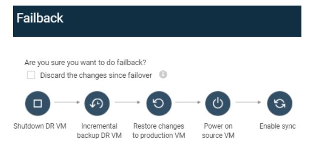

Failback: After a virtual machine has failed over, you can perform a failback operation to return the VM to the original site or a new primary site. A failback operation performs a backup of the VM at the failover site and uses that data to replicate the VM back to the primary site:
  • When a failback is performed after a planned failover, the virtual machine already exists at the primary site and only incremental updates are written from the failover site.
  • When a failback is performed after an unplanned failover, an incremental backup of the VM at the failover site is taken. Then a full replication is performed to recreate the virtual machine at the primary site.

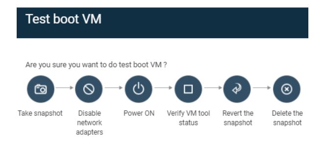

  • Test boot VM: Powers on the destination virtual machine to verify that it is ready for use in the event of a disaster. To avoid conflicts with the source VM and ensure that the virtual machine is not modified by the test boot, this scenario takes a snapshot of the virtual machine before the test boot, boots destination VMs with network connections disabled, and reverts to the snapshot afterward. It is useful during DR drills to validate the destination VM while keeping the source VM intact.
